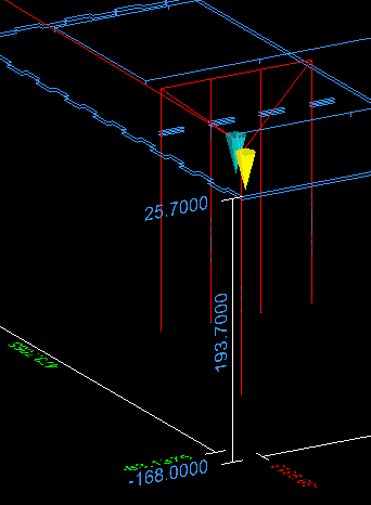

I am not an expert and I spent two days trying to use the Autoleveler Plugin (AP), here is my setup:
Controller AXBB-E, UCCNC v1.2113, AP v 2.0049.
I use an inexpensive Touch Plate Tool as zero probe that is a cilinder hight 19.3mm (tool z offset).
My workflow: load in AP the toolspath g-code generated by Cut2D (post processor UCCNC(mm), the gcode seems ok), setting the AP as in picture
but the gcode sent to UCCNC have a huge z value in the cutting profile: after gatering all probe points, when the CNC begin to cut, the endmill go down to 193mm instead of about 30mm from the travel altitude [attachment=2Screenshot 2024-09-03 221959.png[/attachment].
I hope I was clear...
My question is: do I typed the right parameter in the Autoleveler Plugin (shown in picture)?
Would I use a newer version of the AP? (I tried AP v 3.031 but the tool z offset is missing)
Thank you in advance for any help
