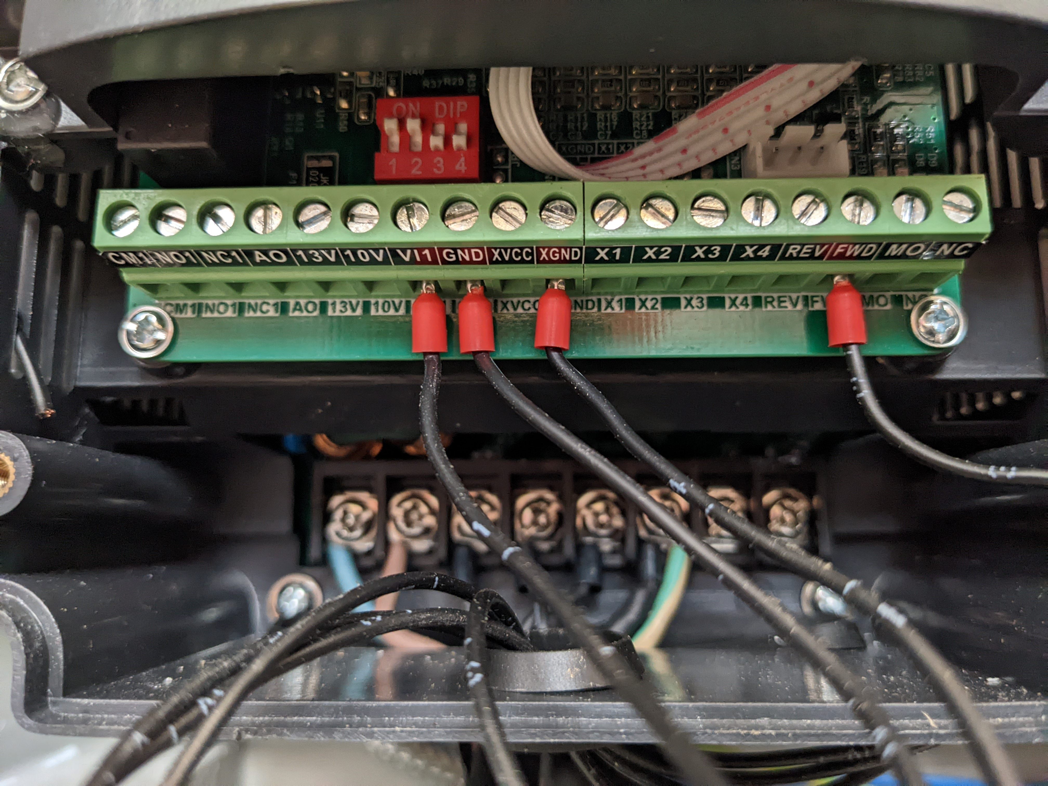

Re: Uc300eth-5ltp VFD Wiring
Postby kiark » Sun May 01, 2022 2:08 pm
Hi there.
I made a picture of the vfd.
I checked every connection and then tested the voltage. Somehow i dont have the needed 12V between p5 and p6 on the analog port. I also checked the other outputs, but they dont have any too. The only pin that supported the 12v was pin 16 (didnt test 8+9). Should they always have voltage or do i have to switch something on?

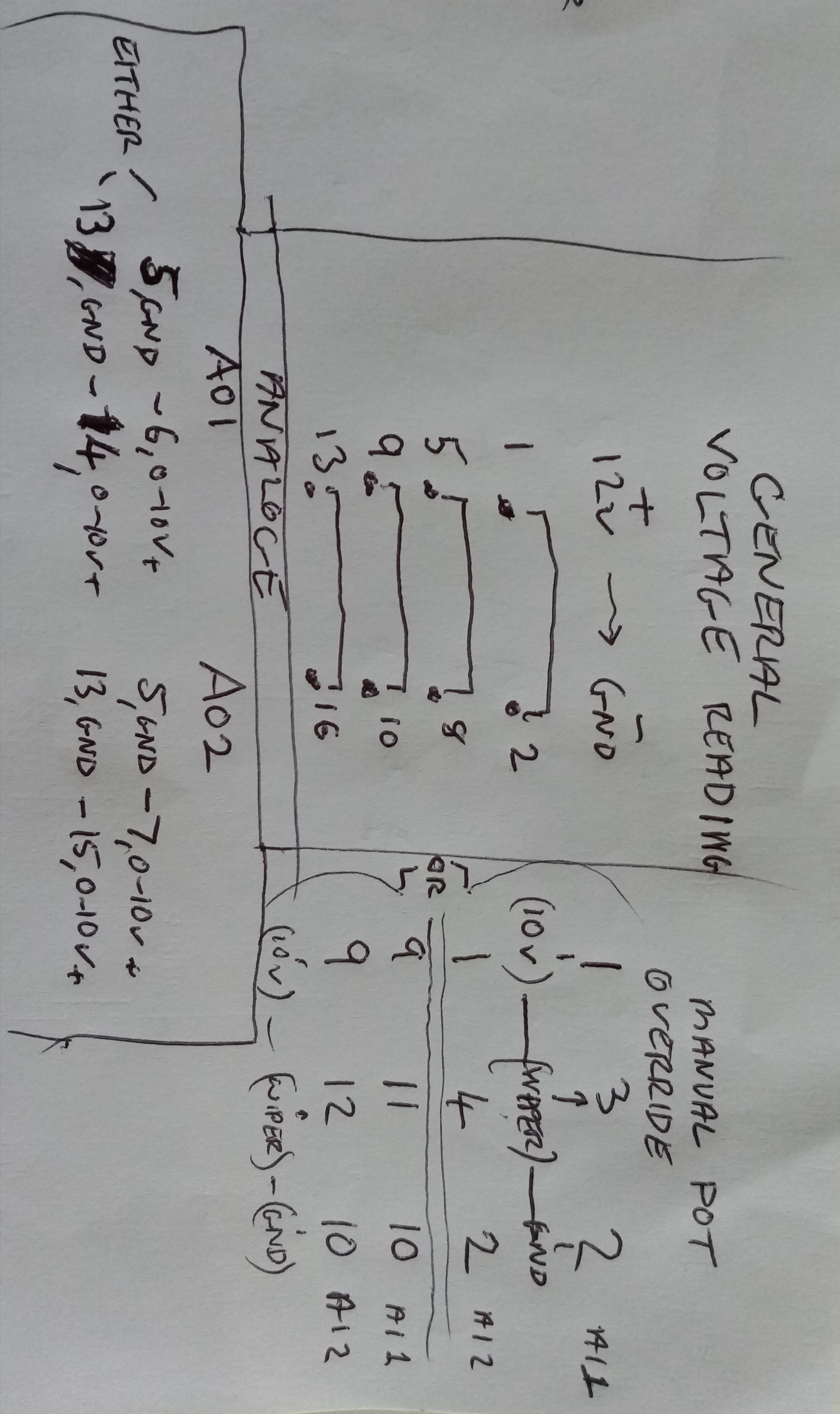

Postby Dazp1976 » Sun May 01, 2022 4:45 pm
kiark wrote:Hi there.
Thanks!
Vfd connections used look dead on. Is same as my pdf diagram from the manual.
Found this I wrote down regarding the analog port pin description. Easier than explaining in words.
Was a bit rough but....
Shows the 12v circuits.
Pins for AO1 and AO2.
How to wire a pot on AI1 or AI2
Dazp1976
