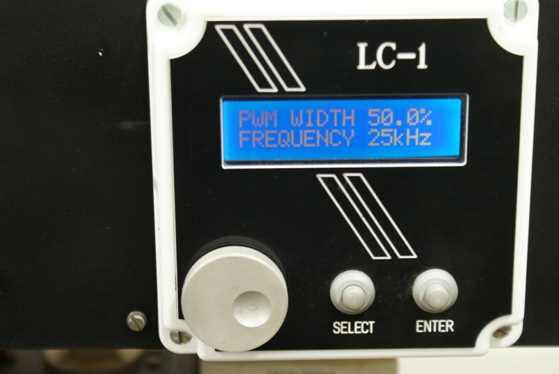

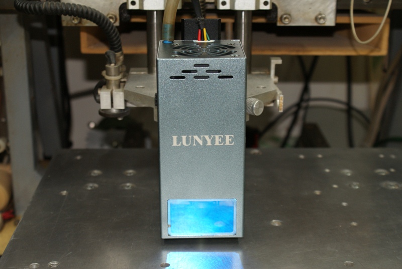

When using the laser plugin with my CO2 laser I have full ‘on the fly’ control of my laser’s actual output power (via. current control). However, when using a cheap Chinese diode laser (which does not have any external diode current control) this is not the case. As the plugin only allows my actual diode laser’s burn to be pre-set (via. Min. / Max. & Feedrate settings) at ‘runtime’ an ‘on the fly’ method of output power control was desired. To this end (using a Microchip processor) I have substituted the 3.125 kHz PWM output from the plugin with a 25 kHz PWM, which has fully adjustable ‘on the fly’ pulse width control which, in turn, is synchronised with the plugin’s PWM output.
I have essentially constructed an ‘in-line’ controller between the PWM output of the plugin and the PWM input to the diode laser. It is still ‘work in progress’ but currently I can adjust the diode laser’s output power ‘on the fly’ between 0 and 100% using a ‘pre-set’ pulse repetition rate between 5kHz and 25kHz.
So far, my PWM substitution is linear but from various test results I am thinking that there may be some advantage to having an adjustable inverse log or inverted S curve for this substitution (assuming my mathematical and programming skills are up to the task).

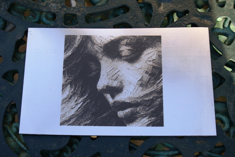

Results are promising - adjusting the laser power 'on the fly' reduces the test time getting the image contrast correct for the final run.

My controller has been constructed to reduce my diode laser’s output power by producing a PWM signal between 0% and 100% of the existing PWM signal output from the plugin. It is convenient for me to output this PWM at a PRF of 25kHz as it will substitute 8 * (0 to 40uS pulses) in place of each 320uS output pulse from the plugin. As I have manual ‘on the fly’ control of the duty cycle of these 40uS pulses my laser’s output power can be adjusted to produce the desired contrast level of the image being reproduced. This reduces my set-up time considerably as I only have to make one partial trial-run for each different material being used.
This method of control is not perfect as it operates in ‘real-time’ with a maximum synchronization delay of 4 clock cycles of a microprocessor running at 20MHz but there is no noticeable degradation of a vertical line when bidirectional scanning at, in my case, an axis speed of up to 6000mm/min. Also, with this method some pixel values are truncated and ‘grayscale’ images may suffer as a result but as I am using ImageR to dither my images I am only really working with 2 pixel values.

The controller I am using is a ‘leftover’ from many years back when I made a number of these for controlling Synrad RF CO2 lasers. It is old technology using a Microchip 16f627 microcontroller which is outdated compared with modern stuff so I would not recommend that you reproduce my design although I do still have the details if you require them.
What the controller does is really simple and could easily be done with an Arduino or other type of ‘ready made’ microcontroller / PLC.
All the controller has to do is monitor the UCCNC plugin’s PWM signal turning on its own PWM output at the leading edge and turning it off again at the trailing edge. This is done whilst polling a setting control for its generated PWM duty cycle.
