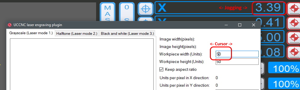

I would like to write my first plugin,
but how can I avoid,
while navigating/editing inside a textfield (using the left/rigth cursor buttons) in my plugin-form
that in the same time the "x-axis" is also jogging to the left/right(because of keyboard shortcut assignment).
I saw this behavior also in
- "PluginTest" plugin
- "the laser engraver" plugin (I added a screenshot)
- WebCam plugin
How can I manage that all "Key/Mouse activities" stay ONLY inside the plugin-form when it has the FOCUS.

Use UC.Disablejog(true) when the form gets focus. Don't forget to reenable with UC.Disablejog(false).
