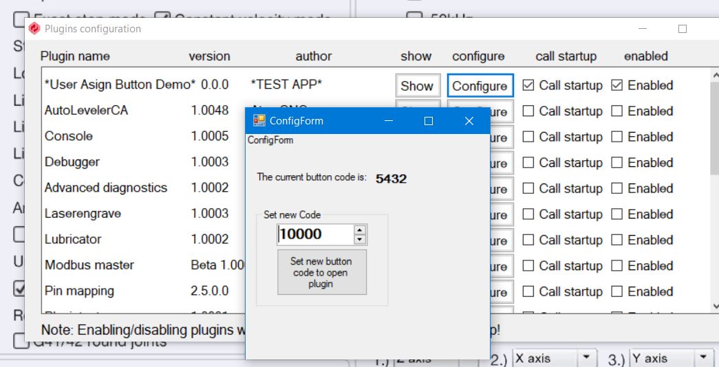

I've been messing around with how to setup a plugin to fire off of a button code that isn't hard coded, but is user configurable. The attached is a demo plugin that allows the user to setup the user assigned button code using the 'config plugin' button in the plugins menu. I've included the whole 'project' file as well as the compiled .dll so it is apparent what I'm doing, using 'my.settings' to hold the user assigned button code.

When ever I 'show' a plugin using the button code (either from a screenset button, or from assigned hotkey), the plugin show up event obviously triggers, but as soon as the form appears, it disappears like UCCNC hid the window. If I'm in the plugin menu and use the 'show' button (showup_event), I can open/close the plugin repeatedly without issue. But as soon as I go back to using a buttoncode to open the plugin, it disappears and I can't get it back until I restart UCCNC.
While troubleshooting this on one of my real plugins, I put msgboxes all over the initial 'form_load' proceedure. When I open the plugin using the button code, it fully loads, and returns back to the main plugin 'Buttonpress_event' (based on all message boxes I set for trouble shooting firing off), and then after that the form window disappears as soon as the 'buttonpress_event' routine completes. I know the plugin is running, because I can call up the 'config' form, and also because it has multiple forms, and sometimes one of the other forms will remain open, but the main form has disappeared with no way to get it back... I've tried adding myform.visible=true, myform.bringtofront... nothing works
