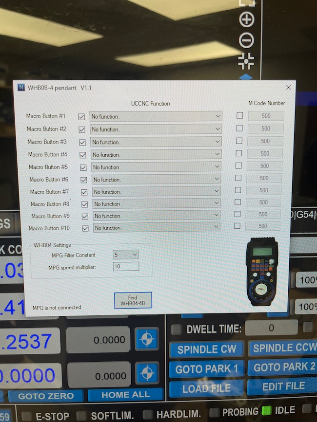

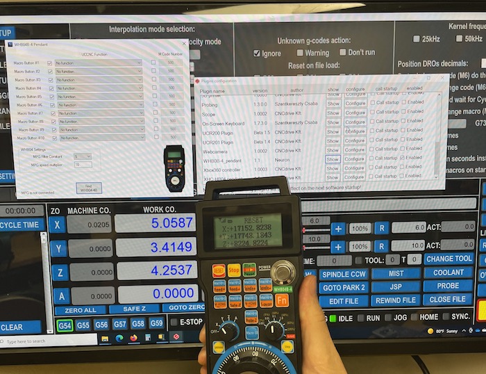

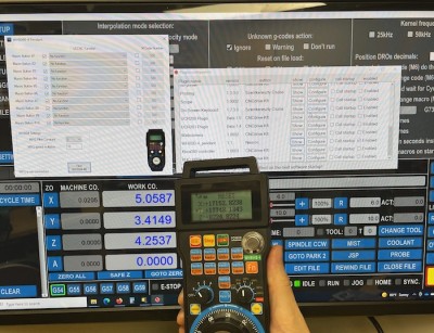

Postby nick_p » Fri Aug 06, 2021 5:17 pm
Hi all, I've been using UCCNC for 1 year now and all is great. I just bought the WHB04B 4 axis version from Amazon and I can't get it to work. I've read through this entire thread a couple of times. I tried the download in the first post, and also 2 other downloads scattered throughout the thread. All have the same issue. It says "MPG not connected". I'm using UCCNC 1.2112 with the simple 4 axis screenset from the UC100 facebook group. Has anyone else had this error? Does anyone know the solution? Could the 1.2112 version be the issue? Could the screenset be the issue? I'd rather not reinstall everything (unless the version is definitely the issue) as my machine is running great. Screenshots below. Thanks!
nick_p
Posts: 4
Joined: Fri Aug 06, 2021 4:55 pm
