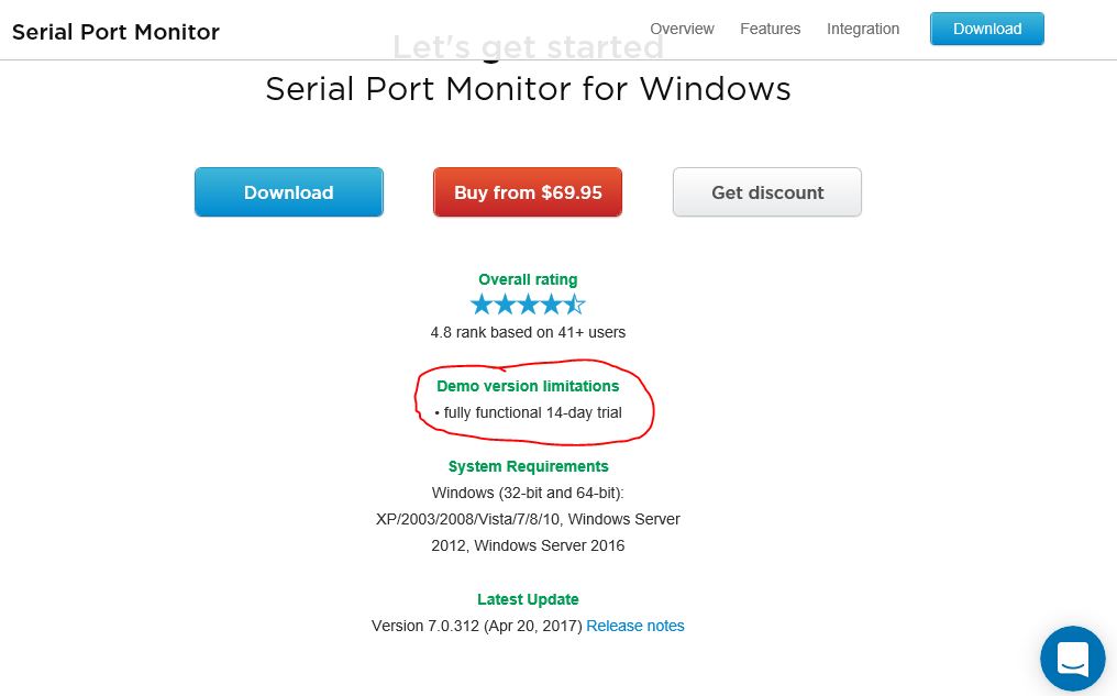

The simplest solution in trouble shooting any Modbus set up and could save a lot of time chasing your tail with guessing is download a free or trial serial monitor. I/you can determine immediately what the problem is. If you need a link LMK.

Postby Dan911 » Mon Oct 30, 2017 12:38 pm
andrewbishop66 wrote:Hi Dan if you could suggest a serial monitor as the only stuff I have is can bus for cars
thanks andrew
https://www.eltima.com/products/serial-port-monitor/
Start Serial Monitor and choose new.(new window will appear)
Choose com port you chose in plugin.
Choose dump view.
Press Start Monitoring.
Start UCCNC with start up and enabled checked for HY12 plugin.
You should see lines of bytes immediately, if you don't than you have a connection problem and should start there.
Dan
