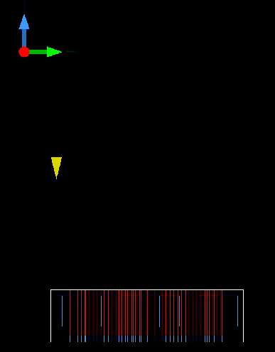

i have an issue with the auto leveller plug in
I have a stepcraft 420 and an 840, i have been using the auto leveller on the 840 with no issues for 2 years now.
i just got the new 420 machine and setup auto leveller as i did on the 840 in uccnc with the stepcraft profile.
the issue i have is that when i apply the leveller to the g-code it places the position of the head higher then it should be,as shown in picture 1.
I ran the same gocode in the 840 and it is where it should be as shown in picture 2.
if i run the 420 using the auto leveller appended gcode it slams the bit into the board surface
here are the differences in the codes after sending to uccnc from auto leveller

I noticed that the initial code is missing:
G00 Y0
G00 X0
G31 Z-1
F10
any help or advice would be appreciated.

Re: Autoleveler Plugin.
Postby ssp » Mon Jun 04, 2018 11:39 am
All is ok, my macro was corrupted, i re-wrote it and all is good again. :D :D :D :D :D
