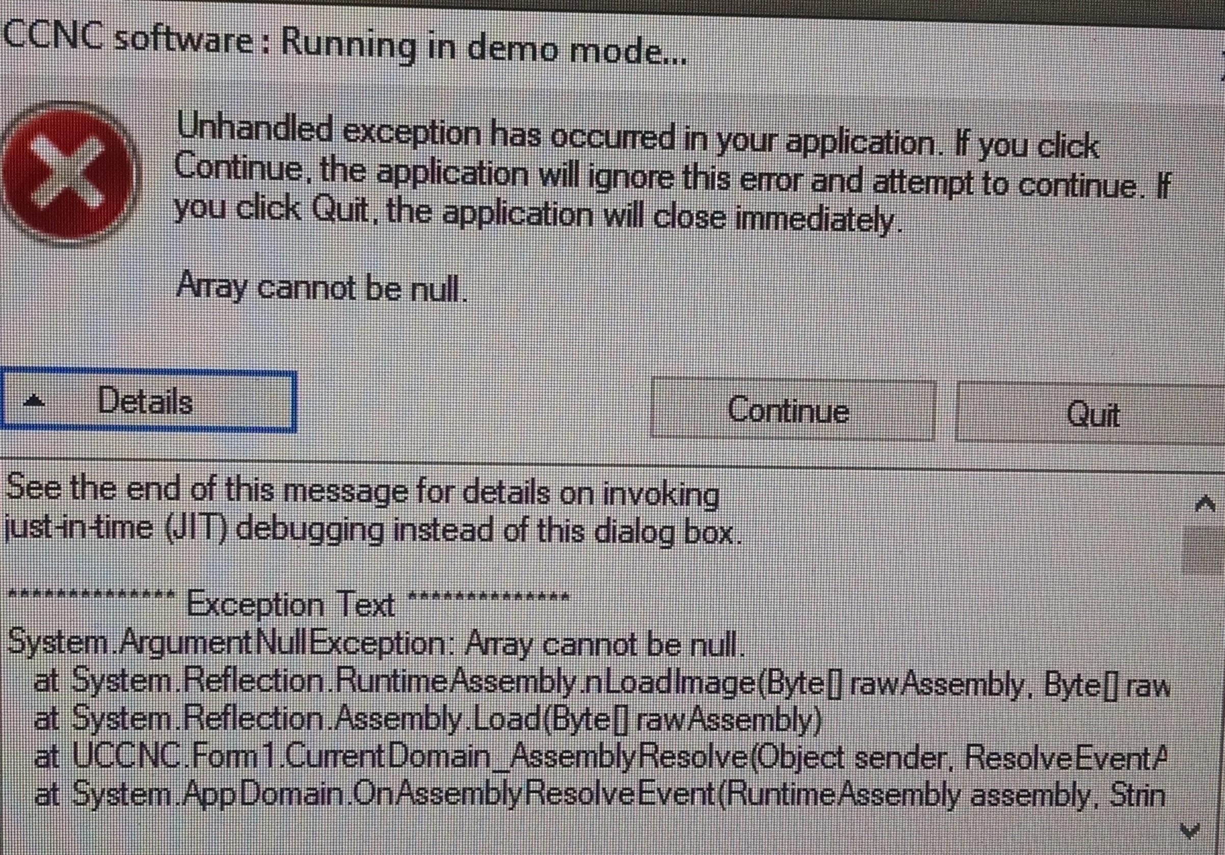

Postby markcadcam » Tue Mar 10, 2020 3:14 pm
I get this error using version 1.2113

Re: ProbeIt for UCCNC
Postby eabrust » Tue Mar 10, 2020 3:51 pm
markcadcam wrote:I get this error using version 1.2113
Hi Markcadcam,
Well thats a bummer... :oops:
Can you give some more info please? Did this happen as plugin loaded, or did it happen after you tried to run some routine?
Postby markcadcam » Tue Mar 10, 2020 3:59 pm
I enabled the plugin, restarted the program and I got that error on start up.
Postby markcadcam » Tue Mar 10, 2020 5:12 pm
Yes, I copied all of the files to the plugin folder.
Below is all of the error messages.
I'm running.
Postby thegreatwaldo » Tue Mar 10, 2020 10:30 pm
Hi Eric
I'm getting the same kind of error as Markcadcam with ver. 2.113 and win7 I'll try it on my machine computer which probably has an older version to see if that works and get back to you.
Here's the error message win7 32bit uccnc 2.111

UCCNC
Assembly Version: 1.0.0.0
Win32 Version: 1.0.0.0

************** JIT Debugging **************
To enable just-in-time (JIT) debugging, the .config file for this
application or computer (machine.config) must have the
jitDebugging value set in the system.windows.forms section.
The application must also be compiled with debugging
enabled.

Cheers
Andrew
Last edited by thegreatwaldo on Tue Mar 10, 2020 10:47 pm, edited 1 time in total.
Postby thegreatwaldo » Tue Mar 10, 2020 10:46 pm
Hi Eric
It's the the Probeituc.dll file that cause the problem stopping the program from starting properly.
Cheers
Andrew
