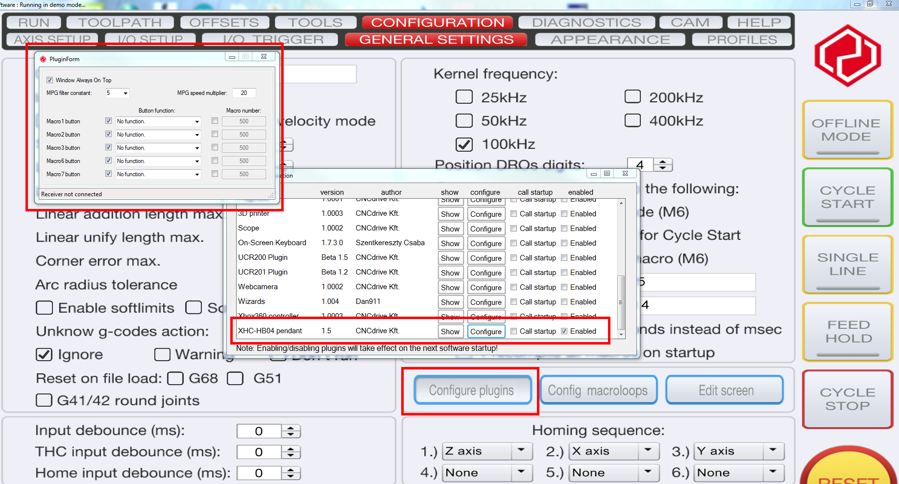

Postby Robertspark » Fri Aug 24, 2018 2:29 pm
There is a plugin kindly provided by cncdrive which you need to enable via
Configuration > general settings tab + configure plugins button
down the bottom of the list is XHC-HB04 pendant
click "enabled"
restart uccnc
then bring up the plugin window again and click configure to set up the buttons / settings

Postby Gene8522 » Fri Aug 24, 2018 5:23 pm
I show that the pendent is connected but I'm not sure what I should set the buttons settings to

Postby Robertspark » Fri Aug 24, 2018 7:32 pm
The buttons accessible from the plugin are just for macros
All of the standard buttons (jog, e-stop etc) are all set within the plugin and cannot be changed.
Does the pendant jog the machine, and toggle the e-stop etc as it should?
