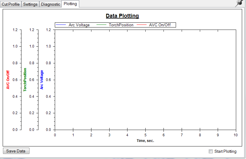

I thought that the scope plugin could be expanded to be a little more visual similar to that available within LinuxCNC (called HALSCOPE)
http://www.wiki.eusurplus.com/index.php?title=Halscope
The advanced diagnostics plugin is a little sparse (i.e. you can only look at the status of the LED's and the VARs), but have no means to log data.
An example of the sort of thing that I was thinking was like Halscope, but what Andrew did with the Neuron with is that shown below.
One of the issues that he had was .NET 2.0 compatibility, and I found a charting DLL (zedgraph) which is available free and may offer a solution for logging + C# (which is what Andrew used for the charting / logging which is available within the Neuron).
http://zedgraph.sourceforge.net/samples.html
