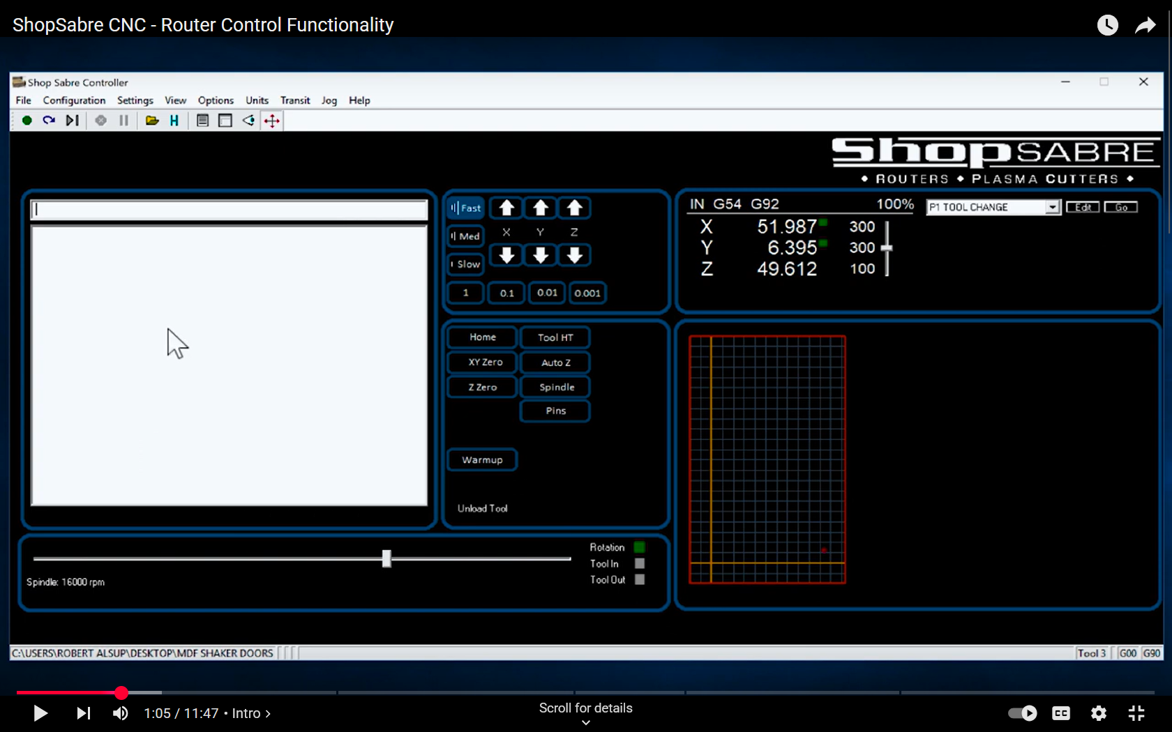

I want to have a simplified Run screen similar to the attachment, Its the Shop Sabre control panel.
To me it looks very simple and clean only the buttons I really ever use, would modify a little to make it exactly what I need.
not wanting to copy it exactly, just the basic layout I like.
Can anyone give me a basic rundown of the steps needed, I currently use the 2022 Screenset and its great overall.
Could I make a new run page on the unused Tab where I can keep the Original Run Tab but have an alternate with the new look / layout?
I purchased the 2022 Screenset Customization files so I think I have all the button / etc. images so I could keep the same look and feel
( Honestly I have not looked at the Customization package very close yet, will do that now )
If I could copy the Run page to another Tab and modify it that would work, just want to keep the original as is.
This would be for my own personal use.
Just a point in the right direction would be great so I don't chase my tail trying to figure it out, I'm old, no time to waste.
Thank You
Ed
Shop Sabre controller screen image
