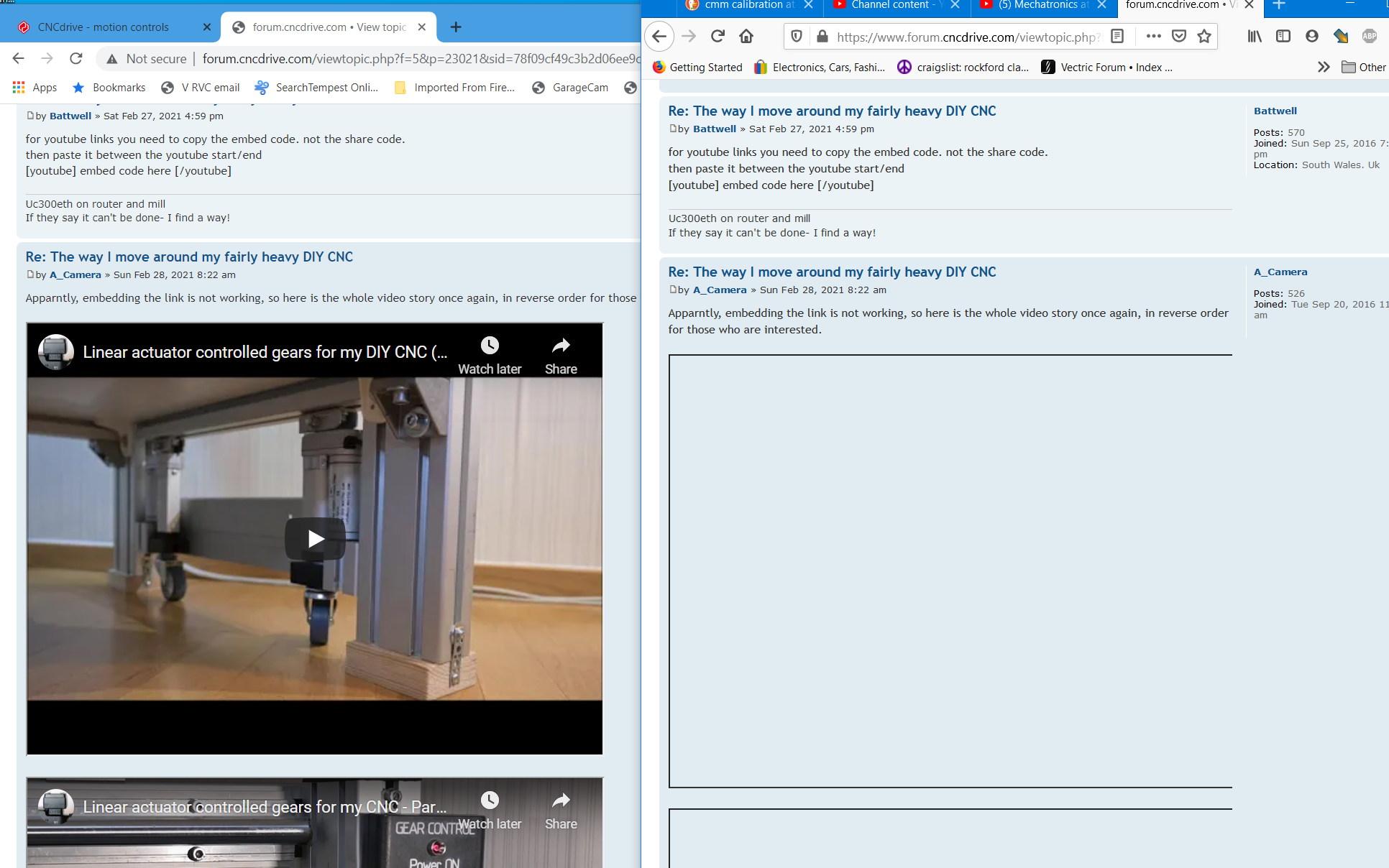

I just noticed that the videos worked on my cell phone ( w/ Firefox ).
Went back to the PC, and Firefox doesn't show the videos, but Chrome Does. Seems to be something related to browser maybe? I'm typically a Firefox user
Here is Chrome on left, Firefox on right:
