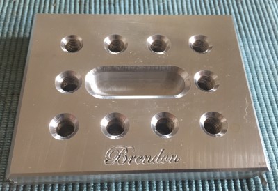

Postby Battwell » Mon Mar 18, 2019 11:27 pm
Test piece
My first test post out of fusion 360 on my mill

Swank. Well done.
FYI - Engraving - I've been successful by running a second pass at the same depth. Smoothes out the tool marks and takes the top burr off most of the time. Not sure I'd try it in something hard, but in brass & aluminum the engraver doesn't seem to dull despite what is probably a 'rubbing' pass.
