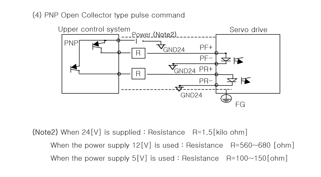

I've included some pics from the servo manual showing wiring for Position control, but they only show CW CCW logic, but there is a pic showing how to set it to step/dir, which I have done. They do mention resistors in the 3rd image, but my youtuber didn't mention them and I don't have the right size handy yet. I'm hoping I've made an obvious mistake that someone will see. I've tried swapping + & - around on the outputs and wiring -- to drive and ++ to drive, but get same result. I have left a comment on the youtubers video, but no response yet.
Generic Wiring for Position Control Using CW CWW logic
Change Logic to Step/Dir
Only example of 5v logic

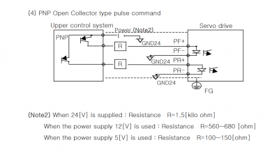

Whoops,there is another example of 5v logic in the manual and I've included the other options that are shown

Ok, I've have to admit defeat. As much as I've tried I cannot get these drives working with the AXBB-E! I've followed the youtube video I linked to and did the same as he. Read thru the APD-VS manual back to front seeing if there is anything else he may not have mentioned, but found nothing. I've tried it directly connected and with 100 Ohm or 150 Ohm resisters on the Step+ and Dir+ inputs on the drives, but nothing will make them move. I can get the drives to come out of alarm and the motors to lock, but not move. I've attached DMM DYN2 drives and motors to the AXBB-E to make sure that it is actually working and they move fine. The APD-VS drives and motors were all working fine when set to Torque control and running under Mach4, except that Mach4 was causing problems and I don't like Mach3/4 and really wanted to use the AXBB-E with UCCNC.
My only choice now it to gut the drives and motors out and replace them with the DMM DYN2 drive and motors, but I really didn't want to have to do that as it SHOULD work!! Frustrating!! Only thing I can think could be causing the problem is the drives and made to work at 24v for the Step/pulse signals, though the manual clearly says you can use 5v and even 12v with the right resisters in the +v side of the pulses. I have Steps+ and Dir+ wired to 5v OUT on the AXBB-E with 100/150 ohm (tried both) resisters on each going into the drive, the O9(step-) and O10(Dir-) going to the inputs on the APD-VS. Would have been nice if it worked.

Postby RsX » Sun Dec 22, 2024 9:54 am
It is not working because you are pulsing the optocouplers with 19-24V, so they are never turning off.
You should use the isolated outputs
The manual is not very clear but I think you can also use the non isolated outputs this way.
Not sure if the Resistor is needed because with differential signal is not used, but with open-collector signal it is.
I would use a multimeter first and check the current using a 560ohm resistor and see if it is needed. Then connect the AXBB-E.
Keep in mind the non-isolated outputs can push/pull 20mA and you don't need more than that to drive an optocoupler.

Postby paulmacc21 » Sun Dec 22, 2024 11:52 am
Thanks for the reply RsX. I just tried it using O1(step) to PF- and O2(dir) to PR- on port 1 and +24v to pin 49 on drive (Pulse COM), (nothing connected to PF+ & PR+ on servo Drive?), but still no movement.
So if I use the non-isolated ports to drive PF+ and PR+ , I connect PF- and PR- to 0v on AXBB? And not sure where/how you want me to check current as I am not so good with the electronics side of things, but thank you very much for replying. :-)

Postby RsX » Sun Dec 22, 2024 1:11 pm
paulmacc21 wrote:I just tried it using O1(step) to PF- and O2(dir) to PR- on port 1 and +24v to pin 49 on drive (Pulse COM), (nothing connected to PF+ & PR+ on servo Drive?), but still no movement.
That is correct, assuming that you also set the new pins in the axis configuration.
Connect the multimeter like this. Put it into mA mode and use the appropriate input for mA.
Check both inputs. You should see a current of a few mAmps. You should also be able to step the motor just pulsing with the multimeter probe.
