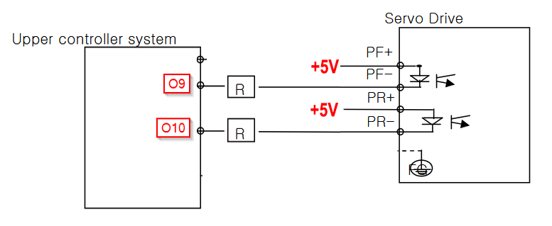

This is the schematic
Or like this. Dealer's choice
http://www.ehaegypt.com/uploads/vsmanual_rmzimqkr.pdf
When the power supply 24[V] is used: Resistance R=1500 ohm, 1/2W
When the power supply 12[V] is used: Resistance R=560~680 ohm, 1/2W
When the power supply 5 [V] is used: Resistance R=100~150 ohm, 1/2W
There is some confusion about the resistor values. But these seems right.
Two 100~150 ohm resitors are needed at 5V.

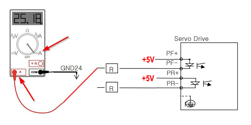

This is how you should test the current with the multimeter
If the current is too low maybe you can remove the resistor, but if you get no current at all, the optocouplers are far gone.

So, testing the opto couplers as suggested I get 15mA or there abouts on each, so they appear to be ok, but still get no movement on the motor, or anything on the Drive LED display. As stated before drive energizes and holds the motor so it is in READY state and there are no alarms, but pulses seem to be been ignored from the AXBB, so am assuming there is something not correct in the way I have set the drive to Position MODE. I can put it in TEST mode and the motor moves at least but that's all.

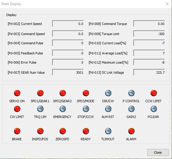

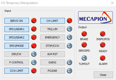

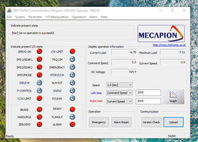

Well, back at it again. Having found the windows config software ("Mecapion Communication") and a suitable CN3 to serial converter to USB cable, I have been able to connect to the drives and view the config data thru the software. Alot easier that doing it thru the LED display and buttons on the drive. Also I can download all the settings as a PDF doc, so I can compare what's different between Pulse and Torque control modes.
Here's what I can see below when set in Position/Pulse control. "P Control" doesn't seem to do anything and I think is used for the mixed mode "Speed/Position" control. Apart from that the I/O State between Pulse and Torque Modes seems the same, so I'm back to either and missing option not being set on the drive or it not liking the way it's receiving the pulse/dir signals. In frustration I hooked up a Masso G3 Touch controller to the drive (as shown here https://www.forum.cncdrive.com/download/file.php?id=5012&mode=view, 1st option) to see if that would move it but no luck. This was how they said to connect it for a similar type drive in their docs. I'm quite sure it's just something I'm doing wrong but can't see it. I'll include the PDF of the settings I'm using for Position mode, compared to the original setting(that worked!) for torque mode.

Can Change Some settings here temporarily

Detailed live settings

Live settings Overview
