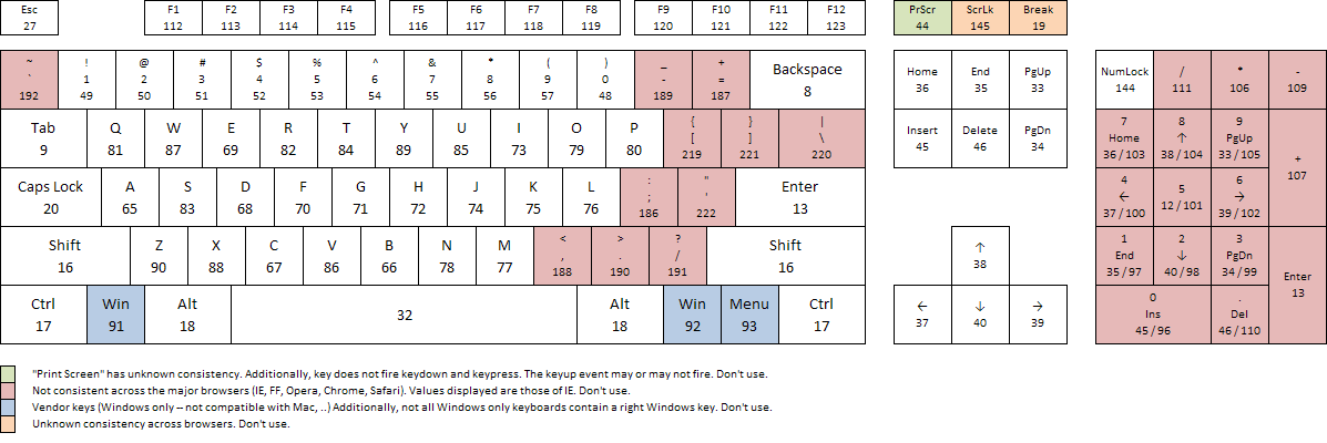

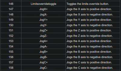

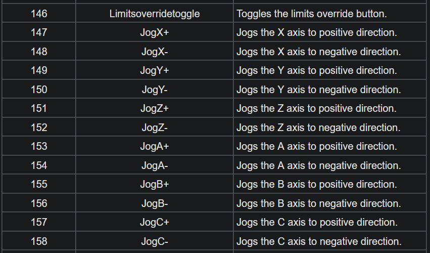

Klokworker wrote:While I'm writing, a feature request: can lathe mode change the Z axis jogging keyboard keys to be the up and down arrow keys, like Y axis jogging in 3-axis mode?
I think you can change this section here to assign the new keys
[Hotkeysettings]
Keycode1=39
Buttoncode1=147
Keycode2=37
Buttoncode2=148
Keycode3=38
Buttoncode3=149
Keycode4=40
Buttoncode4=150
Keycode5=33
Buttoncode5=151
Keycode6=34
Buttoncode6=152
Keycode7=45
Buttoncode7=153
Keycode8=46
Buttoncode8=154
Keycode9=81
Buttoncode9=155
Keycode10=65
Buttoncode10=156
Keycode11=87
Buttoncode11=157
Keycode12=83
Buttoncode12=158
