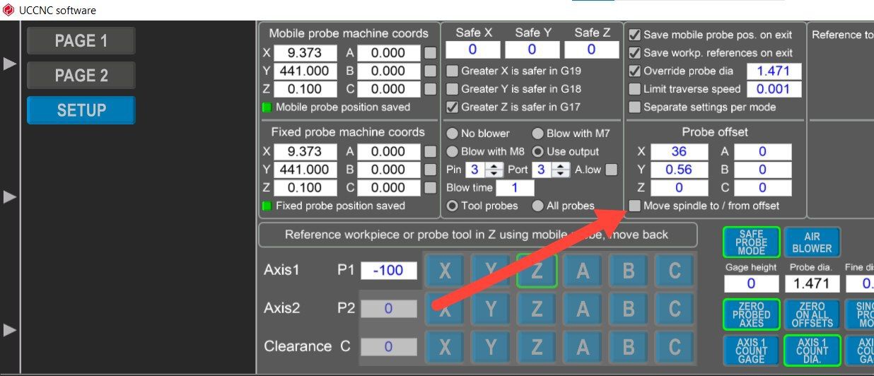

cncdrive wrote:- On which page and where is the "Moves spindle to/from probe" function? This plugin was developed by one of my collegue who dies in December, so I have to check this myself, but quickly looking I could not find this button.
The function in question is located in the "Probe" section (as shown in the attached image). Its purpose is to account for the probe offset during measurements. However, I have noticed a limitation in its current implementation.
For example, when I use the "Reference Probe as Workpiece" function, I expect the probe to touch the workpiece surface first and then—considering its offset—make contact with the tool length sensor. However, at present, the system performs this operation by touching the sensor with the milling tool instead of the probe.
Since I cannot create two different sensors—one for probing with the probe and another for probing with the milling tool—I would like the system to take the probe offset into account when this function is activated. This way, the measurement would be performed using the probe itself rather than the milling tool.

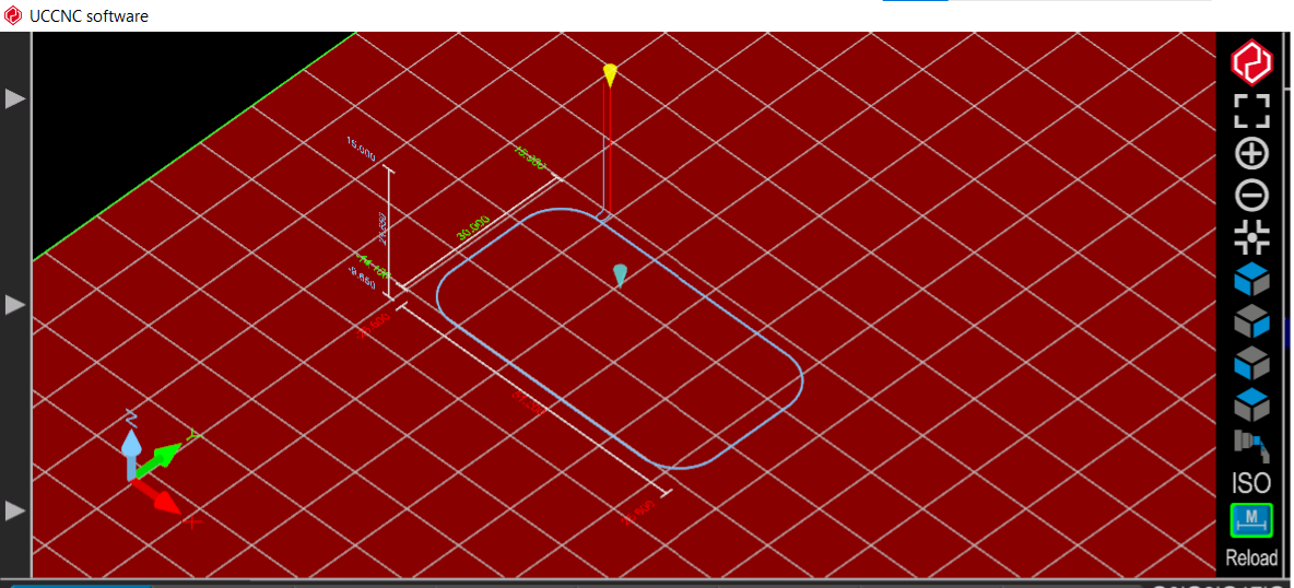

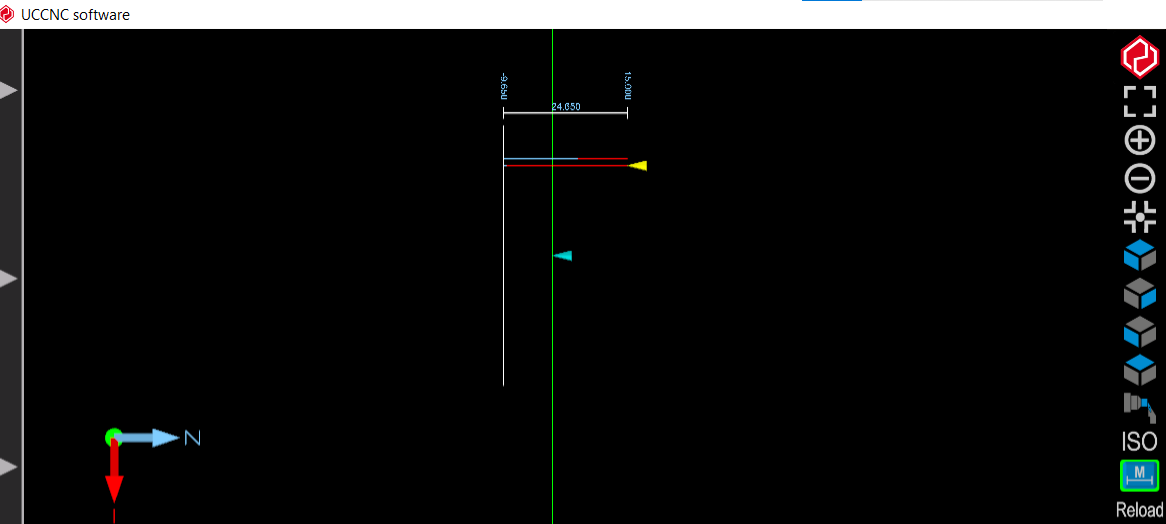

cncdrive wrote:-I don't understand the last point about front view trajectory display.
The photographs show the program image in iso and front mode. In the front view, the image is rotated 90 degrees and the z axis is directed horizontally, while it should be vertical.
