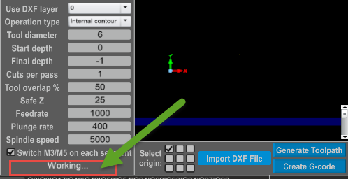

Hello,
Importing a simple dxf file off a box 100.0mm x 100.0mm it says always "working".
UCCNC V2117
Best Regards,
Marco Gaspar
cx.dxf
(415 Bytes) Downloaded 73 times

Postby cncdrive » Fri Jan 31, 2025 11:48 am
It loads at me, but the file loads empty.
It is probably somekind of file compatibility issue, but I don't have time now to check it out.
I tried to open and save it in LibreCAD and after that the file loads without problems.
