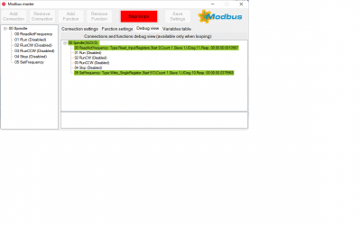

I managed to get the devices to communicate however after some time (minutes to hours) the functions get stopped to be called/updated:
I see on the Waveshare device that the TCP connection is still active, ModbusMaster just stops to send the requests. Restart of the Waveshare device doesn't help (Modbus Master doesn't reconnect), I need to stop and start "loops" in the plugin screen to get it working again. I tried to play with various parameters, timeouts etc on the device site without success, when I try to change the "loop interval" in the plugin it seems that for longer internal (100ms) the problem happens later (however not sure about this). I think that the problem is on the plugin site.
Plus there are various "UI state indication" bugs in plugin's debug view, e.g.:
- above case (everything is green but no data transfer performed)

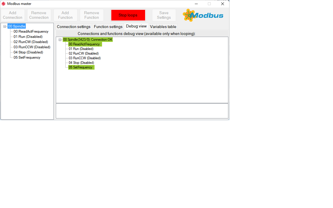

- when the device is misconfigured (not replies) but accepts the connection i see this in debug view:
so all green and again no hint about the problem
