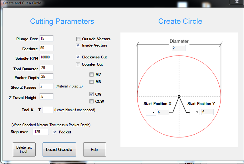

Thought I'd give Wizard V6 a spin and have a problem. I hit Start to clear the temp file and created a 2" pocket .25" deep in 2 passes at X6,Y6. The generated Gcode has my Z plunging to -.625" right off the bat. The second pass moves to Z-.75".
What am I doing wrong?
Ed

Postby Dan911 » Tue Jul 03, 2018 9:33 pm
epracefan@gmail.com wrote:Hi Dan and thanks for creating this.
Ed
Hi Ed,
You are not doing anything wrong, if you try running code in offline mode or demo mode you will see it runs correctly. I think what you are missing is that after your Z.5 (Z travel setting) move to X6 Y6 there's a
G91(incremental Mode).
Your settings are to pocket .25 in 2 passes(.125 per pass)
.5 + .125 = -0.625
Back to Z travel setting (.5) than back to X6 Y6 for second pass(.125)
.5 + .25 = -.75
