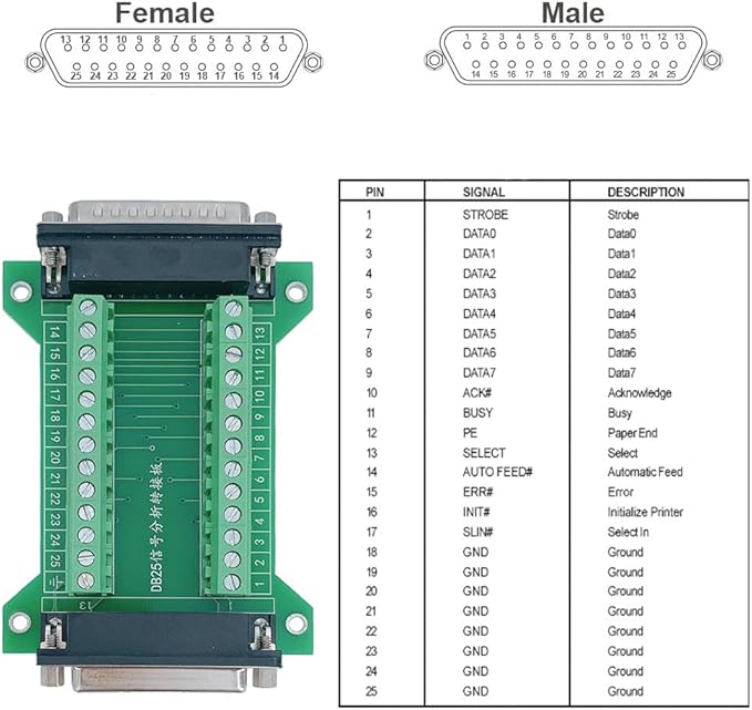

Would it be workable to use a DB25 to DB25 BOB like one of these between the UC100 and the G540 to access the additional outputs of the UC100?

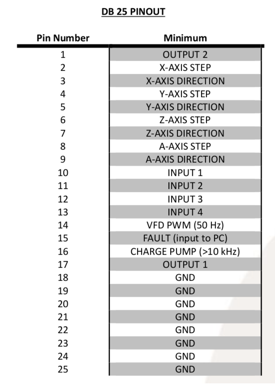

Based on the G540 pinout diagram, it doesn't appear that I have enough leftover outputs for step/direction for 2 more axis. Or am I missing something?
