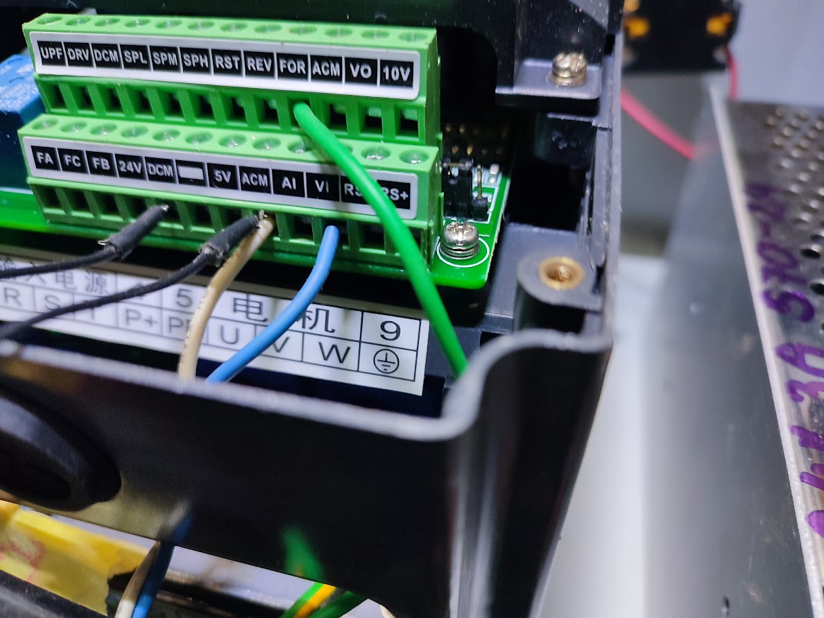

here on HY VFD there are two lines of terminal 1 and 2 which ACM should I use form 1 or from 2 ?
is this correct connection ?
uc300eth + UCBB
analog port UCBB pin 5 ground ------> HY VFD ACM ( terminal 2 or terminal 1 ? )
analog port UCBB pin 6 analog output 0 ------> HY VFD VI ( terminal 2 ? )
uc300eth CN2 output O17 ------> HY VFD FOR ( terminal 1 from photo )

sorry i made mistake when posting connection of corse UC300 has an analog port :)
after posting that i was looking for a sollution and i found on one forum that someone had a problem that when it was connected to AXBB-E same way he wasn't able to control RPM so he connected ground to DCM
sollution for AXBB-E
A01 = VI
ACM = 5V0
DCM = 24V0 ( I just don't understund why [b]24V0 and not the same from 5V0 as common - is alsways same on PCB ) [/b]
FOR = pin 7 port 1
REV = pin 8 port 1
pid001 on vfd = 1
pid002 on vfd = 1
I done the same just shorted ACM and DCM and now it is working. Now it is just need a small adjustment with pd159 and pd160 need to be set to 0 I assume as UC300 gives only 9.85 V from analog port so it is a small deviation in RPM, even changing signal on vfd to 5V (pd070 if i remember to change signal voltage on VFD as well ) and setting it in uccnc to 51% it sligthy better let say S12000 it will speed up to 12048 but still not super accurate .
I will play with thise setting probably today as I have still some wiring to correct after "made in china" :)
So here is a correct I think way to connect HY VFD to UC300 and UCBB at least it work's for me
ps: I just had a small wire on hand for tests (black one :P )
I just dont know why on few tutorials especialy with mach3 people are connecting 10 V or 24 V + to that vfd can any one explain me that ?

I just purchased and setup the AXBB-E ... Amazing (that's from someone who had an NVEM prior (terrible)).
Anyway, my understanding is that the pins being used for (FOR pin 7 port 1, and REV pin 8 port 1) these are isolated outputs (certainly are on the AXBB-E)
and so are putting out +24v and that's why DCM needs to be 24v0 to complete it.
the vfd VI is hooked upto AO1 which outputs either 5v or 10v and so on mine the ACM is then hooked upto the 5v0 to complete that.
