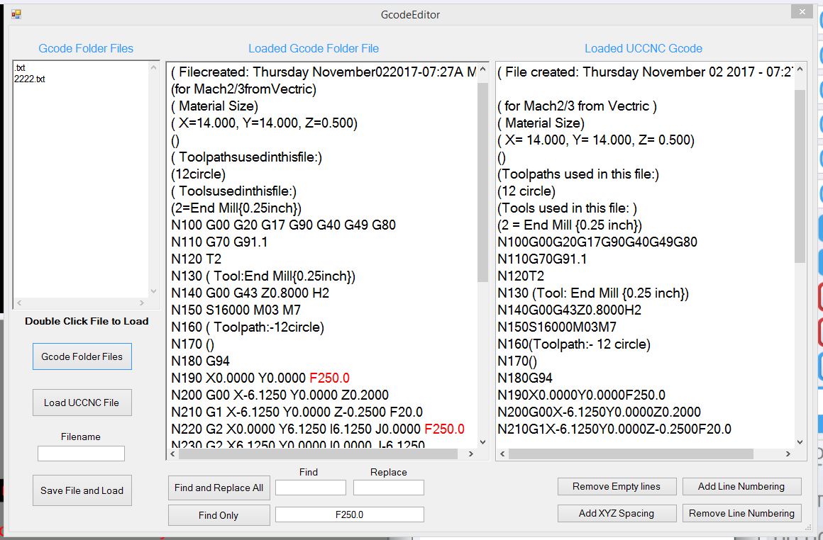

Postby Dan911 » Sun Nov 04, 2018 7:37 pm
Hi Terry,
I added a window for loaded Gcode in UCCNC so not have to deal with both open. Is this what you were asking me for? Just needs some editing bells and whistles but almost 3 hours of coding for fun is enough
for1 day.
This will add a folder to UCCNC "GcodeEditor" and this is where the plugin will look for files and save them. When you first try this folder will be empty so when you press the "Gcode Folder File" button nothing will happen until you populate it with Gcode files. It will only find .txt and .tap files. You need to have a Gcode file loaded in UCCNC or the button press will do nothing. When saved that file will be loaded in UCCNC.
Make a button or hotkey #7777
Terry.zip
(5.24 KiB) Downloaded 6 times
Posts: 468

Postby Vmax549 » Sun Nov 04, 2018 9:04 pm
Hi Dan . It does not seem to want to startup. I tried Button 7777 and a hotkey 7777.

Postby Dan911 » Sun Nov 04, 2018 9:45 pm
Hey Terry, Needs Net 4 versions, 05 or 06, don't know why I did that, I just started to play and get involved. Per instructions if G-code file not loaded in UCCNC button press will do nothing. Created in and tested on 8.1 64 and just tested on XP 32 and no problems on this end.
Posts: 468
Re: Gcode Veiwer
Postby Vmax549 » Mon Nov 05, 2018 1:46 am
OK I got it working here. You are off to a good start ;) . Are you thinking of completing it ?? Or just having fun.
