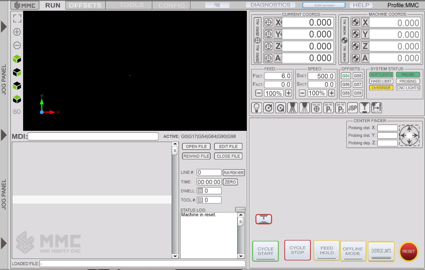

Thank you for your detailed replies. Much appreciated. My goal is to have commonly used probing's on "RUN" screen (I left some space for all that stuff):
Sadly I'm not good on creating macros. I can modify or adjust them a bit at the most. So I'm very happy that You are sharing some of Your great work. Any plans to make such probing routine using new probing method (using tTrip point values) ? :) :)
