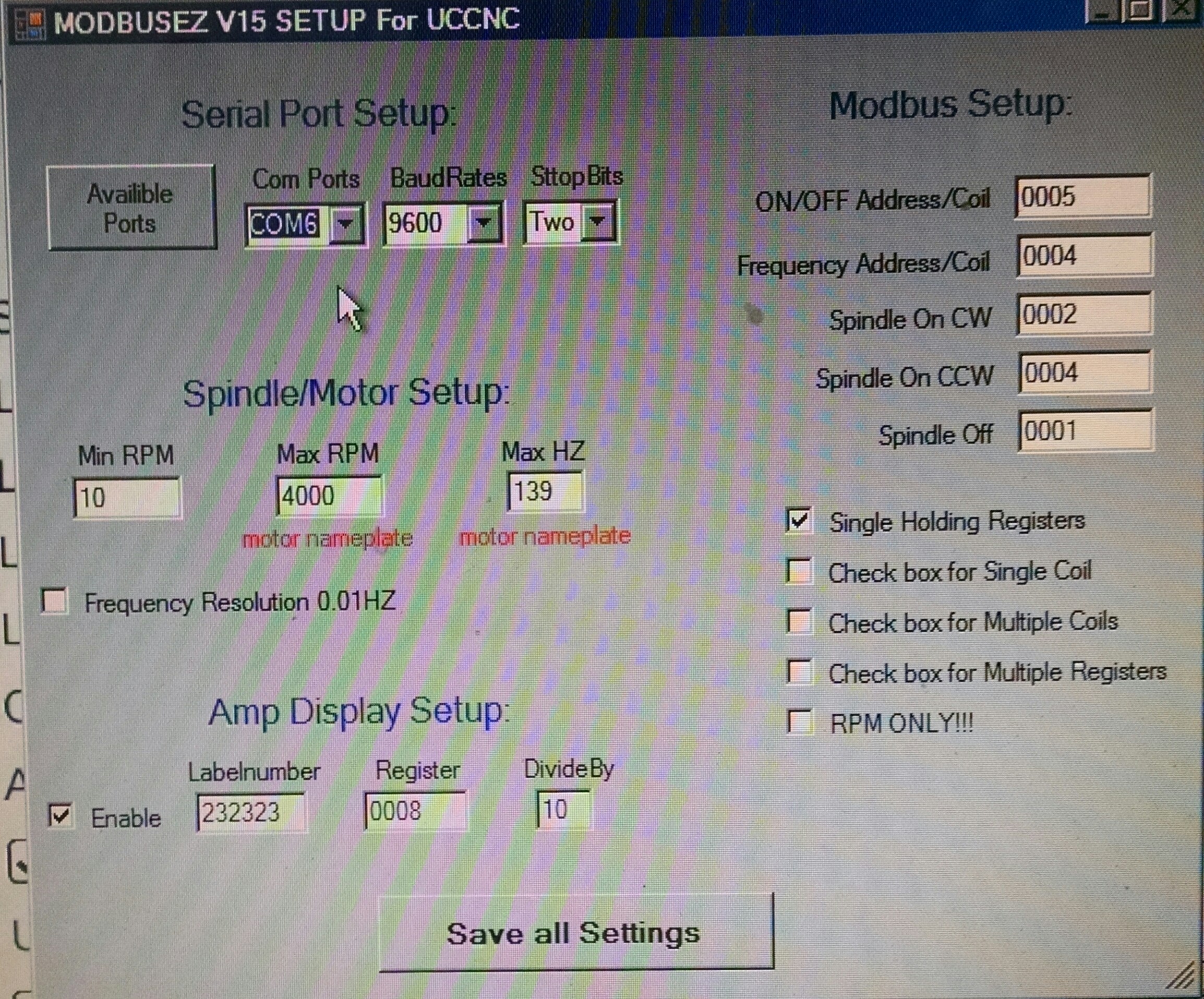

Screenshot of ModbusEZ that worked for me:
(Note that the Amp/current register address is also decremented from 0x009 to 0x008 ! )
