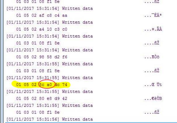

Sounds like your spindle is turning on but no frequency(RPM) is set.
With serial monitor look for line the begins with 01 05 02, the next 2 bytes is the frequency being sent in hex. Example below.
The polling is quick so use the slide bar on spindle override in 2017 screenset or + in default a few times than pause serial monitor to find.

Please take a pic of serial monitor so I can see what frequency is being sent and what plugin is sending, plugin should be sending a 01 03 01 08 f1 8e string for off and 01 03 01 01 31 88 for CW on, frequency sent is explained in post before this 1. This all can be checked with serial monitor.
