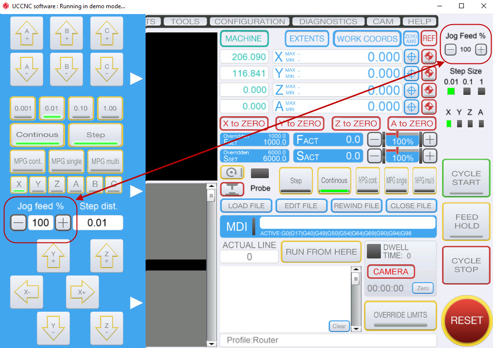

Postby Greolt » Mon Feb 08, 2021 9:43 am
Andrew
First let me say that I very much appreciate that you have provided this plugin for UCCNC users.
It encouraged me to go buy a pendant.
Now a question out of left field. In the pic of my edited router screen you will see that I have reproduced the "Jog Feed %" controls on the front page.
I never use the jog panel. I like all my used features available on the front page.
When using the plus or minus buttons on either panel the percentage changes in both places as you would expect. All good.
However when turning the right hand dial on the pendant only the jog panel % changes, not the one on the front page.
If by any chance your code includes a line like, AS3jog.Setfieldtext("xxx", 913); would it be possible to add the next line, AS3.Setfieldtext("xxx", 913);
913 is the number of the "Jog Feed %" field
I am no programmer and do in no way want to tell grandma how to suck eggs.
So please excuse me if I am talking rubbish.
Thanks again, Greg

Re: WHB04B-4 Pendant Plugin
Postby shad » Tue Feb 09, 2021 11:04 am
Not see any problem to make it.
Today try to make a changes and upload a new plugin.
Postby shad » Tue Feb 09, 2021 8:33 pm
Ready.
Postby Greolt » Tue Feb 09, 2021 8:57 pm
Andrew
That is amazing! I cannot thank you enough.
No one else will ever need this and yet you have done this version just for me.
THANK YOU
