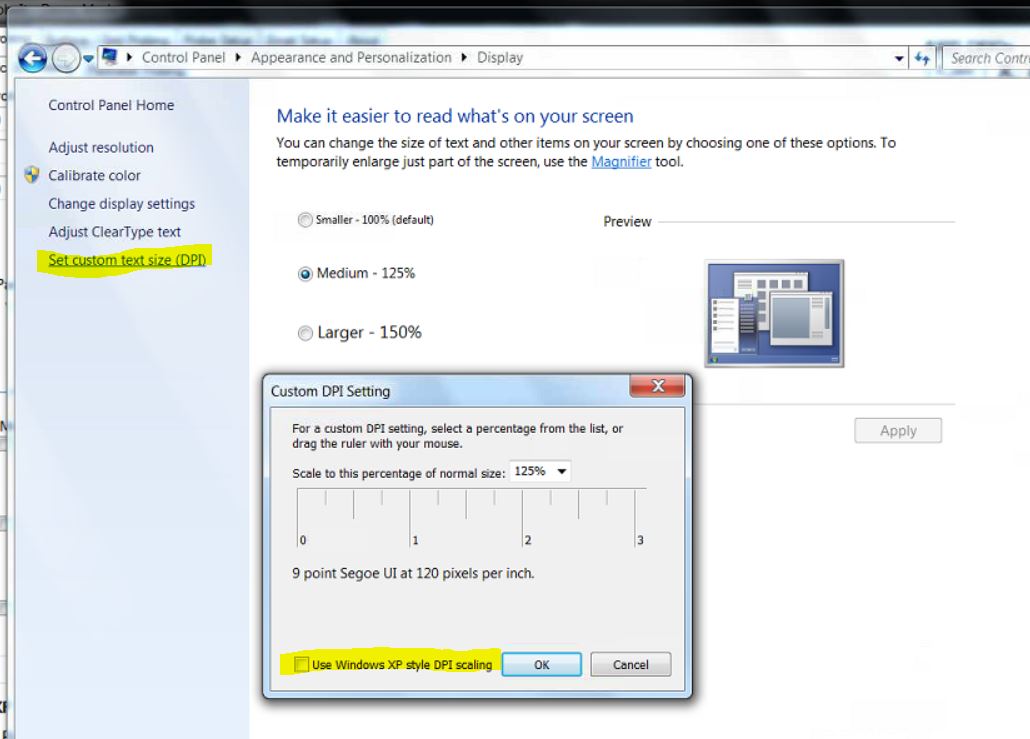

Fingers crossed, I think I just finally turned the scaling problem on and off on one of my windows 7 PCs....
Go into the screen settings where you turn on the scaling factor, and hit 'set custom text size DPI', in the little popup box that appears, UNCHECK 'use windows XP style DPI scaling'. After logout/login, With that unchecked, I can run the scaling at 100, 125, or 150 with no load issue.
Hopefully it works for others.

Re: ProbeIt for UCCNC
Postby thegreatwaldo » Fri Mar 27, 2020 1:09 pm
Hi Eric
No Luck i'm afraid. I'll try checking out some other settings. use windows XP style DPI scaling not working tick box greyed out.
Postby thegreatwaldo » Fri Mar 27, 2020 6:04 pm
Hi Eric
I got it to work when logged in as Administrator. However on my normal loggin the little dpi box is greyed out so i'll have to do some googleing to fix that.

Postby eabrust » Sat Mar 28, 2020 2:56 pm
thegreatwaldo wrote:Hi Eric
Cheers
Andrew
Hi Andrew, thanks, are you confirming that unchecking the box fixed it also? If so, it seems like that is on the right track as being the issue!
