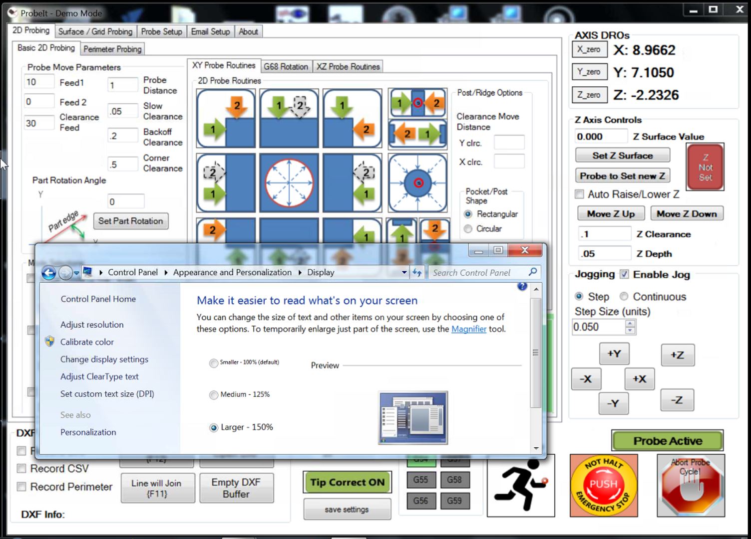

Well I seem to be unable to duplicate the weird loading behavior, which will make it hard to trouble shoot here.
This screen shot is on Windows 7 32 bit, resolution of 1600x1200, scaling set to 150%, and it still loads fine even though it takes up the entire screen (this is a full screen screenshot).
At least I did find some references online to issues related to the scaling with some suggestions on setting behaviors of some of the controls, so I will try making some tweaks and recompiling to see if I can improve it for those with issues.

Hi Eric
It must be a text scaling problem. I have a 4k monitor and if I set the scaling to anything apart from 100% the window is wrong (I have tried this on most different resolutions)

While I've been unable to duplicate the weird load behavior on any of my computers that others have seen, I've spent some time going through the plugin trying to lock down and adjust things that may be affected by the window sizing. So I've put an updated version at the normal link location, with no functional changes to the plugin other than modifications to the form and controls to hopefully correct display issues.
If you had issues, please let me know if this version works better for you. I recommend you don't overwrite your XML file (saved settings), let it complain that items are not found when it loads, then hit the 'save settings' button to update the xml file for next time you open the program.
Plugin update, I just posted an updated version 1.002 of the plugin to download. This version only has changes to the form/controls to try and correct display issues. No new features or corrections to functional aspects.

Hi Eric
More problems with the latest version. I get an error message can't find control and the interrface still doesn't line up unless I use 100 % scaling on windows 7

Hi Andrew,
Thanks for taking the time to check that for me. Unfortunately, I'm not surprised that it repeated. I've been testing using 4 different computers here, 2x w/ windows 10, and 2x w/ windows 7 (x86), and I can't get it to repeat on any of my computers, no mater the screen resolution or the font scaling selected....
I wonder if there is possibility it is a Windows 7 only type issue that is related to if some update has been applied or not? Either way, at this point, I'm going to say if I can't reproduce it, I probably can't fix it. If anyone has run it on Windows 10 and had it load weird, please let me know.
FYI, the 'can't find controls' error isn't really an error, it was expected because your settings XML file didn't align with the layout of the controls on the forms. I will make note to adjust that error message to be more meaningful, such as "Please hit 'save settings' button to update settings XML file" :)
