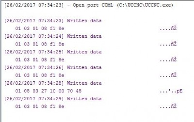

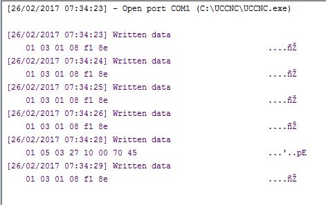

Postby Dan911 » Sun Feb 26, 2017 12:26 pm
The attachment Serial Monitor.JPG is no longer available
Sorry for delay in responding, I have family in from out of town.
I cannot open file you uploaded, posting an image of just the Dump screen would be fine.
The image below is what I'm looking for, if I was connected to my VFD there would be read responses under each written

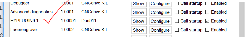

Loaded 9.1 version, set parameters. Closed and opened UCCNC.
No show on the spindle.

Postby Dan911 » Mon Feb 27, 2017 5:24 am
Gordon, Call startup needs to be checked also.
I'm sure there's a "VFD NOT RESPONDING" window behind UCCNC main screen.
