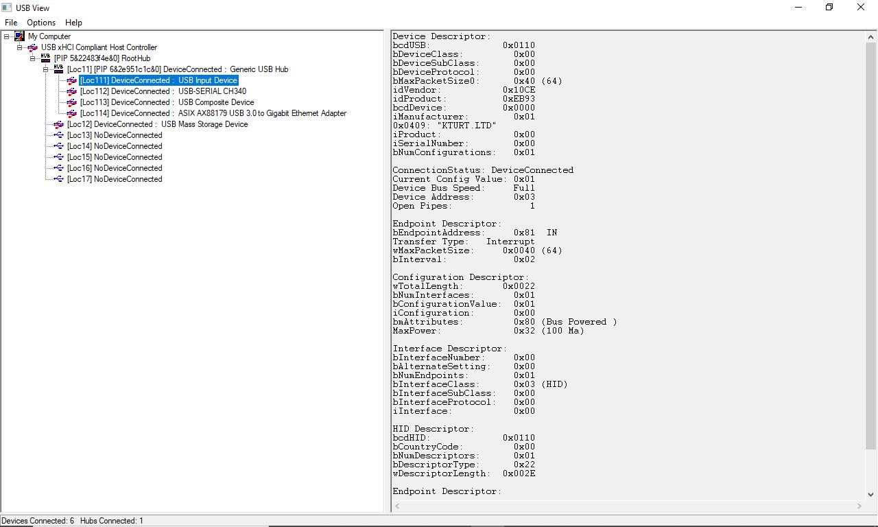

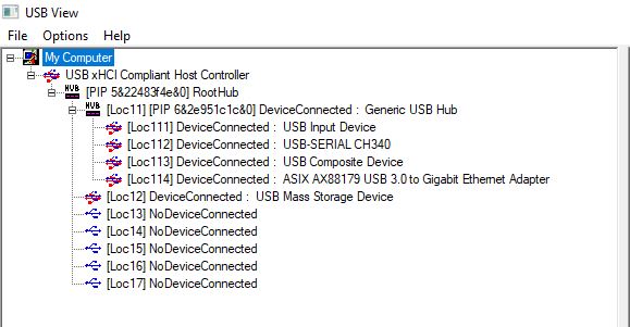

Hi Shad I downloaded the file and ran it here is the screen shot.
This works flawlessly with Mach 3 together with the UC 300ETH and has done for over two years. The PC is a little stick PC running Windows 10 that plugs into the back of my monitor via its HDMI plug and then I have the spare USB socket used for an ethernet and usb hub with the UC 300ETH, the RS 485 modbus adapter for the VFD and finally the wireless usb for the pendant.
As I mentioned previously I'm running the Neuron driver as the last one posted does not do anything at all there is no communication to the pendant at all. The Neuron one does not allow continuous motion via the pendant wheel but step operates perfectly. Also once in step mode my qwerty keyboard loses the ability to allow movement via the page up down home and end keys.
Hope all this information helps and again really appreciate the time you guys are taking.
JIM

Postby shad » Tue Mar 31, 2020 7:07 am
formantjim,
Please run usbview.exe, click on the USB Input Device and in the right panel you can see all information about connected mpg.
You can take a screenshot of this panel and post.
-- Andrew

Postby formantjim » Fri May 01, 2020 10:58 pm
Hey Shad sorry for the delay in responding to your request to run the usbview software. I've been away from my machine just returning to it tonight and managed to run the file whilst connected to Mach 3 and UC300ETH see attached.
What is it you are looking for in this file?
Cheers JIM

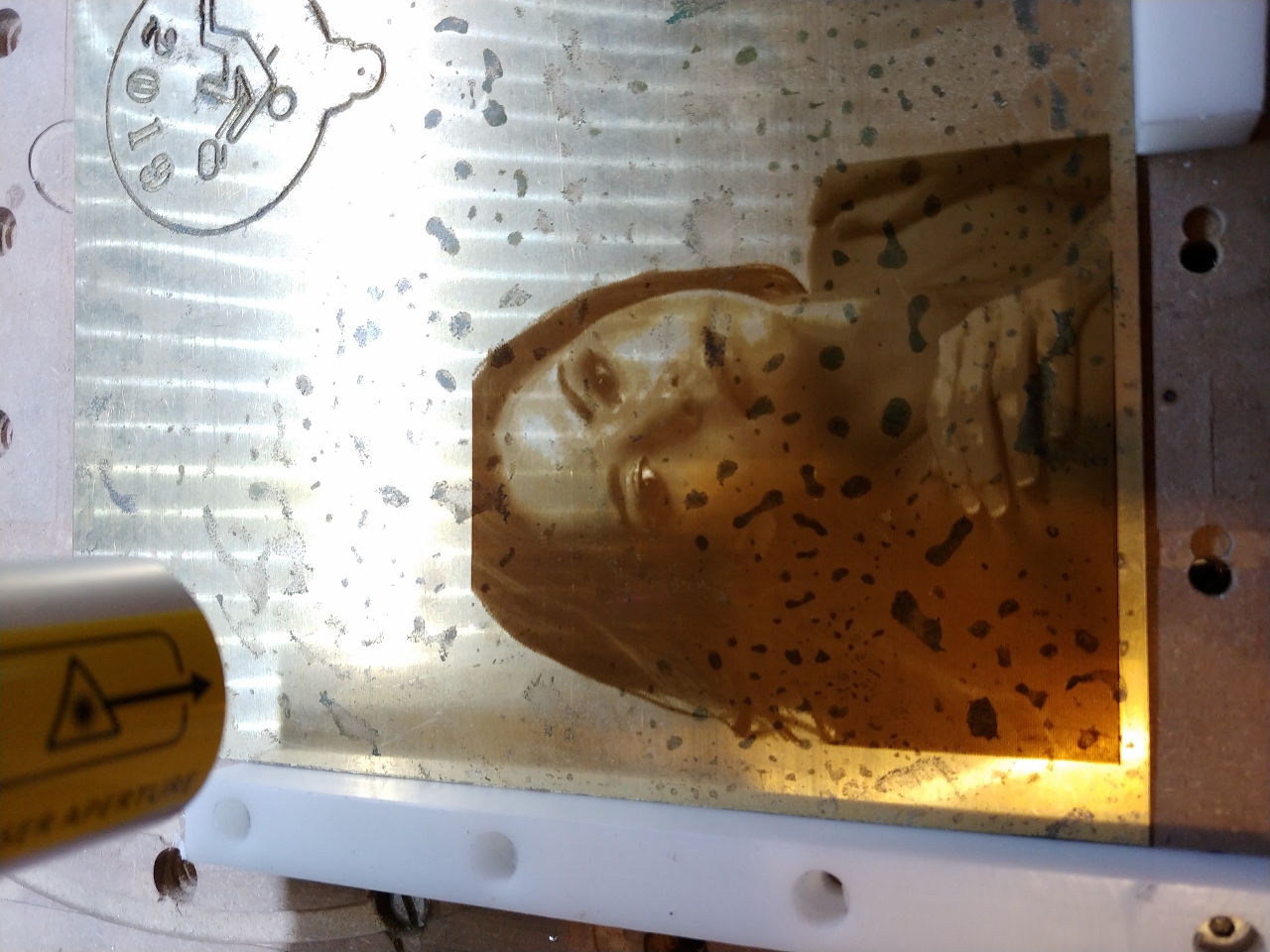

Postby formantjim » Tue May 05, 2020 1:09 am
Well after extensive testing on a couple of PC's I determined there must have been something corrupt with the UCCNC software. When I loaded the plugin and then configured it a little icon appeared in the task bar at the bottom and was not visible on the machines screen. I reloaded UCCNC and voila it now works perfectly. I cannot thank you enough Shad for the plugin. I have today managed to make UCCNC work on my CNC/Laser machine and produced stunning results.
Here i'm just using the engrave plugin within UCCNC of a random image from the web engraving on brass with PWM control of the 10W fibre laser.
