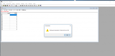

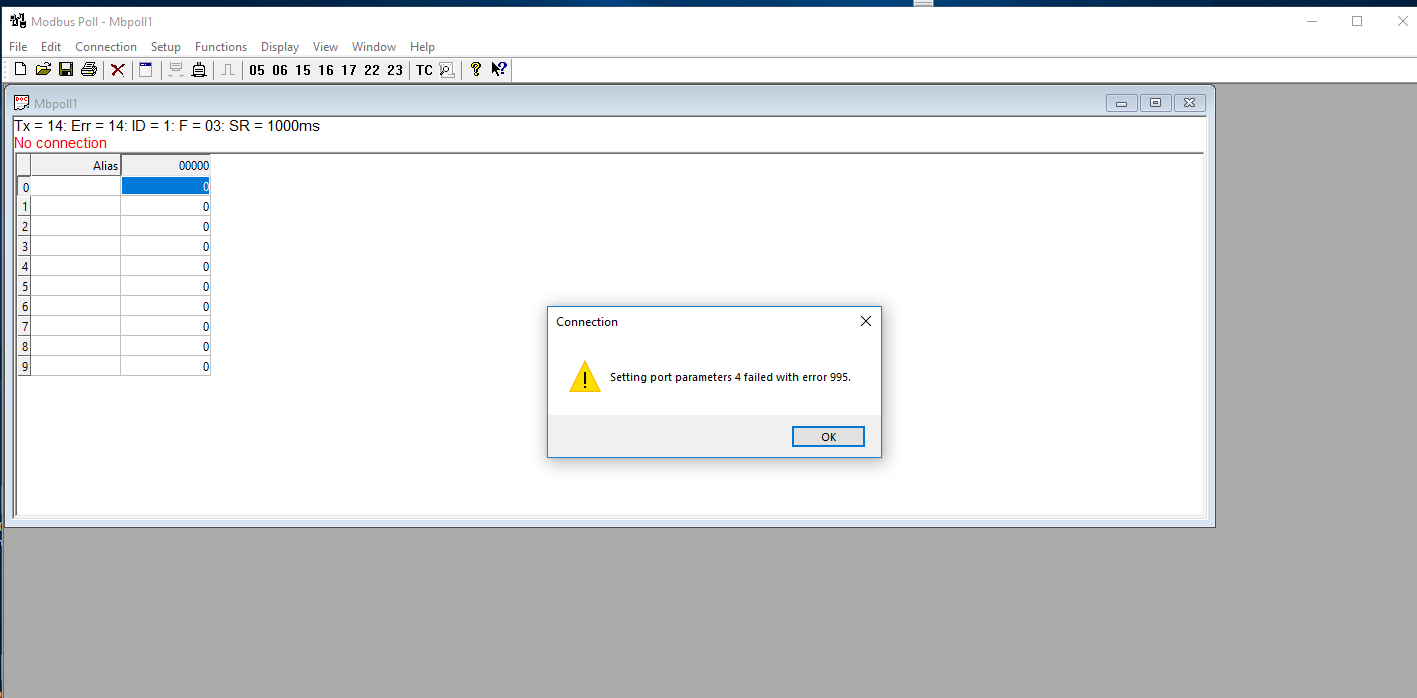

Postby Paklic » Fri Sep 13, 2019 10:42 am
connected via modbus poll
Modbus not connection
Paklic
Joined: Mon Sep 09, 2019 7:55 pm

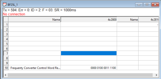

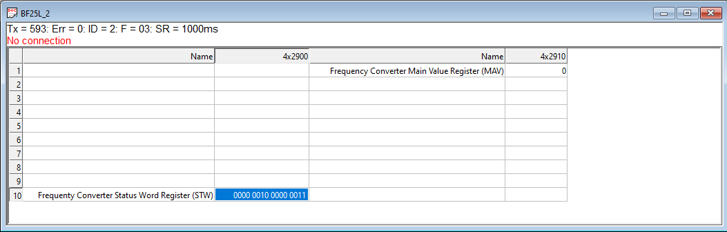

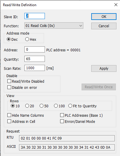

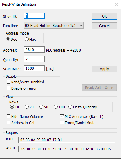

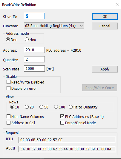

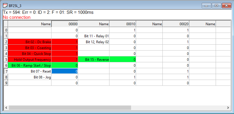

Looking for some help with my setup ( A Danfoss vlt51 Micro)
I've got it working over rs485 with "Modbus Poll", added some screengrabs from that.
When it comes to the plugin made by Dan I have some issues figuering out what goes where (manual added below)
Thank you in advance!
