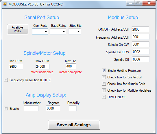

i had 1 Parameter set otherwise than you. it was the # of stopbits. i reconfigured the vfd and also the plugin.
the same if i press spindle start cw or ccw nothing at the vfd.
after that i imported your complete Settings and tried it out.
nothing. the vfd won't start.
so i will Play with the Settings and hopefully it once will work.
if i can bring the vfd to work i will tell you what was wrong. i am to silly for this stuff - but i don't give up.

Postby alex_s » Mon Mar 12, 2018 11:00 pm
i assume the register in uccnc is set correctly ?
the VFD is on before you start the PC ?
have u set the Sact field to the proper label number (857 or so )
since you wrote that the Terminal commands worked it can only be a wrong configured Plugin ( com port parity etc ) or wrong communication settings

Riese wrote:hi dan,
i am new to all of cnc. i am starting to build up all the electronics and found your plugin. it seem to be a very great one. at the Moment i am not able to test it
because of the following Problem.
today i tried to use the modbusez 1.15 plugin within uccnc (latest Version)
after configuring the plugin (COM2, 9600, 1) i saved the settings, closed all windows and closed uccnc.
as i opened the config window again and no values were in the port settings.
then i tried again but its always the same – the values were gone when reopening the plugin.
what do i not understand, making wrong?
is there a trick to save them?
thx in advance
udo
Hi udo,
I posted a partial clip of your pro file and you can see ModbusEZ is sending same strings as the string array's you posted that worked with other program. The only conflict I see is you posted your set up on com 2 and your pro file shows COM 5, these are the settings you need to check like Alex suggested.
Selectedport=COM5
SelectedBaud=9600
StopBit=One
CaDD=2000
FrqADD=0001
ONCW=0001
STOP=0006
ONCCW=0002
Function=6
DisplayField=
SpindleStop=0106200000060208
SendCwOn=01062000000143ca
SendCwwOn=01062000000203cb

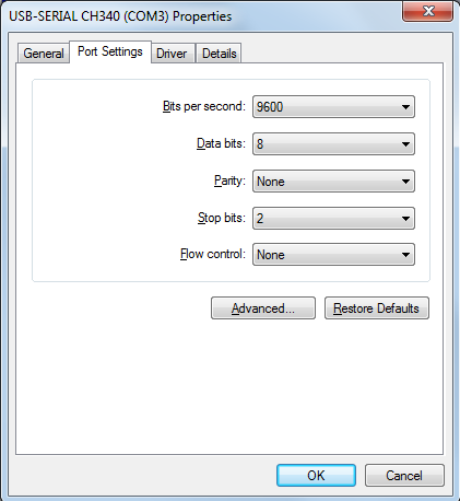

make sure stop bits are set to 2 in uccnc and the device manager

Quick look at PT manual and parameter default setting for F9.01 Data format is 0= 8-N-2. You can either change setting to 3= 8-N-1 or leave it alone and use Two Stop Bits in ModbusEZ Serial Port setup. I see in you pro file your using One Stop Bit and this could be your problem if you didn't change F9.01 from default setting.
Re: MODBUSEZ Plugin
Postby alex_s » Tue Mar 13, 2018 1:02 pm
when i changed it to 8-n-1 it was flaky even with their software, and since there was no harm i set it to 8-N-2
