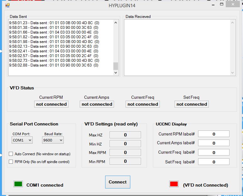

I never finished writing install notes in previous post and will post here. This HY version don't have a configure window, you will get a window on startup when first
enabled where you set your comport and baudrate, baudrate must match VFD setting. Modbus id is set to 1 within plugin along with 8N1 for RTU (PD165). You than can
check AutoConnect and wont see window on start again. To restore window goto CONFIGURATION/GENERAL SETTINGS HYPLUGIN14 and press "SHOW" There also isn't any save button, this is done by events automatically.
From window you will be able to view new features such as Current RPM, Current Amps, Current Frequency and Set Frequency. From the "UCCNC Display Section" you can add the labelnumber for a created textfield if you choose to add to your screen.

With Plugin enabled and when UCCNC first starts up it will try to connect to VFD to get settings, when plugin sees no connection to VFD you will get a window to try to connect again or exit. Just exit.
When ready to use VFD got to "CONFIGURATION/GENERAL SETTINGS/Configure Plugin/HY14" and press show. The plugin window will display and press "Connect"
