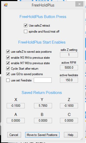

Hello all, sorry about the multiple versions but being my only tester sometimes things get missed. I'm fairly confident I'm there with bug removal, a least from any serious ones.
I added a option to enable/disable spindle and coolant off on button press, this way it can respond the same as a freehold press
but still have the option of moving axis where you like than return to Gcode program when ready.
The instructions are the same, put plugin in plugin folder and check enable, change your freehold button number to 12345
To use:
Press "Freehold" button to stop with Gcode running, and press "Cycle Start" to continue with Gcode. A initial movement window will appear on cycle start press with available options.
